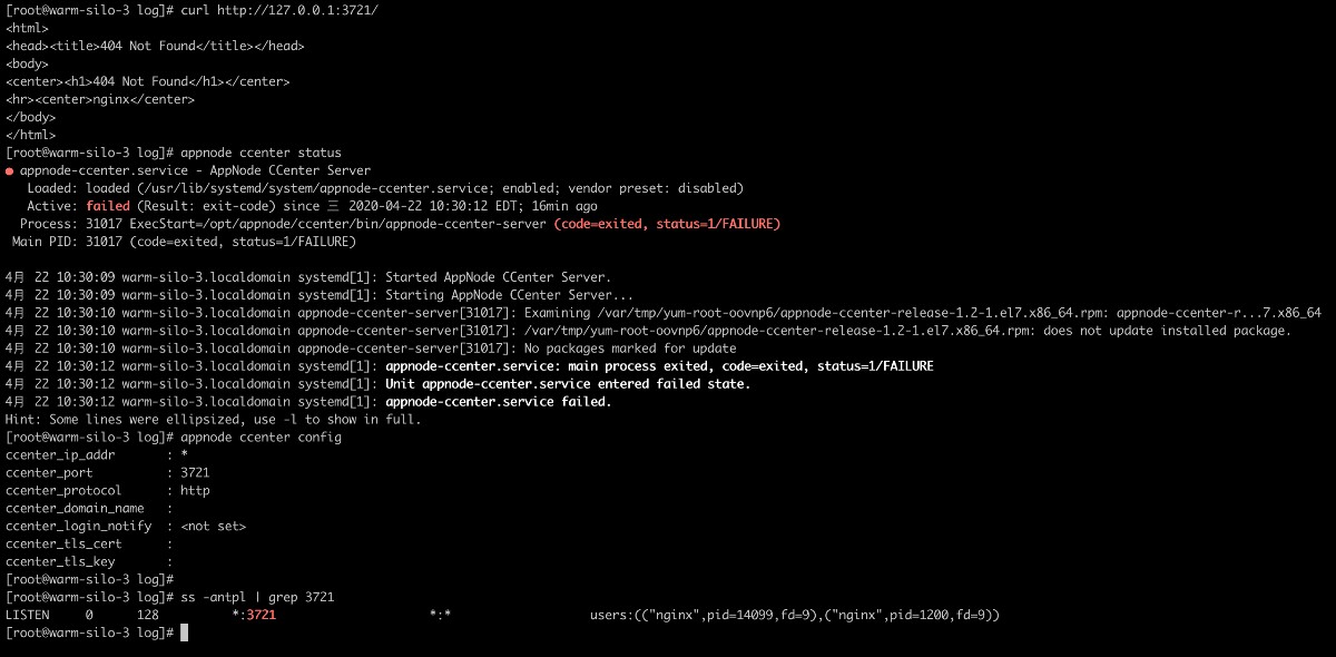

重启服务器之后就遇到这个问题了,求大神帮忙看下

  • 虚竹 2020-4-22
    同一个端口只能被一个程序使用。
    你的控制中心和nginx同时在占用3721端口。
  • ericlll 2020-4-23
    虚竹 同一个端口只能被一个程序使用。 你的控制中心和nginx同时在占用3721端口。
    大神,刚刚将控制中心的端口改为3722 重启服务器还是会报错
  • 虚竹 2020-4-23
    看日志 /var/log/appnode/ccenter.access.log

    大神,您帮忙看看:
    ^[[31m04-21 08:32:32.731 ccenter-server » ERRO 006^[[0m [ccenter_ui.go:237 RunUI] listen tcp 0.0.0.0:3721: bind: address already in use
    ^[[31m04-21 08:32:33.731 ccenter-server » ERRO 007^[[0m [ccenter_ui.go:237 RunUI] listen tcp 0.0.0.0:3721: bind: address already in use
    ^[[35m04-21 08:32:34.732 ccenter-server » CRIT 008^[[0m [ccenter_ui.go:235 RunUI] listen tcp 0.0.0.0:3721: bind: address already in use
    ^[[31m04-21 08:36:37.879 ccenter-server » ERRO 006^[[0m [ccenter_ui.go:237 RunUI] listen tcp 0.0.0.0:3721: bind: address already in use
    ^[[31m04-21 08:36:38.880 ccenter-server » ERRO 007^[[0m [ccenter_ui.go:237 RunUI] listen tcp 0.0.0.0:3721: bind: address already in use
    ^[[35m04-21 08:36:39.881 ccenter-server » CRIT 008^[[0m [ccenter_ui.go:235 RunUI] listen tcp 0.0.0.0:3721: bind: address already in use
    ^[[31m04-21 23:12:11.713 ccenter-server » ERRO 006^[[0m [ccenter_ui.go:237 RunUI] listen tcp 0.0.0.0:3721: bind: address already in use
    ^[[31m04-21 23:12:12.713 ccenter-server » ERRO 007^[[0m [ccenter_ui.go:237 RunUI] listen tcp 0.0.0.0:3721: bind: address already in use
    ^[[35m04-21 23:12:13.714 ccenter-server » CRIT 008^[[0m [ccenter_ui.go:235 RunUI] listen tcp 0.0.0.0:3721: bind: address already in use
    ^[[31m04-21 23:13:58.790 ccenter-server » ERRO 006^[[0m [ccenter_ui.go:237 RunUI] listen tcp 0.0.0.0:3721: bind: address already in use
    ^[[31m04-21 23:13:59.791 ccenter-server » ERRO 007^[[0m [ccenter_ui.go:237 RunUI] listen tcp 0.0.0.0:3721: bind: address already in use
    ^[[35m04-21 23:14:00.792 ccenter-server » CRIT 008^[[0m [ccenter_ui.go:235 RunUI] listen tcp 0.0.0.0:3721: bind: address already in use
    ^[[31m04-23 07:37:27.331 ccenter-nodemgr » ERRO 036^[[0m [agent_conn.go:303 func1] get ccenter token failed: ActionNotExist: API action does not exist!

  • 虚竹 2020-4-23
    仍然在使用3721端口啊
  • ericlll 2020-4-24
    虚竹 `listen tcp 0.0.0.0:3721: bind: address already in use` 仍然在使用3721端口啊
    明白了,感谢大神;
    修改端口问题解决了。
